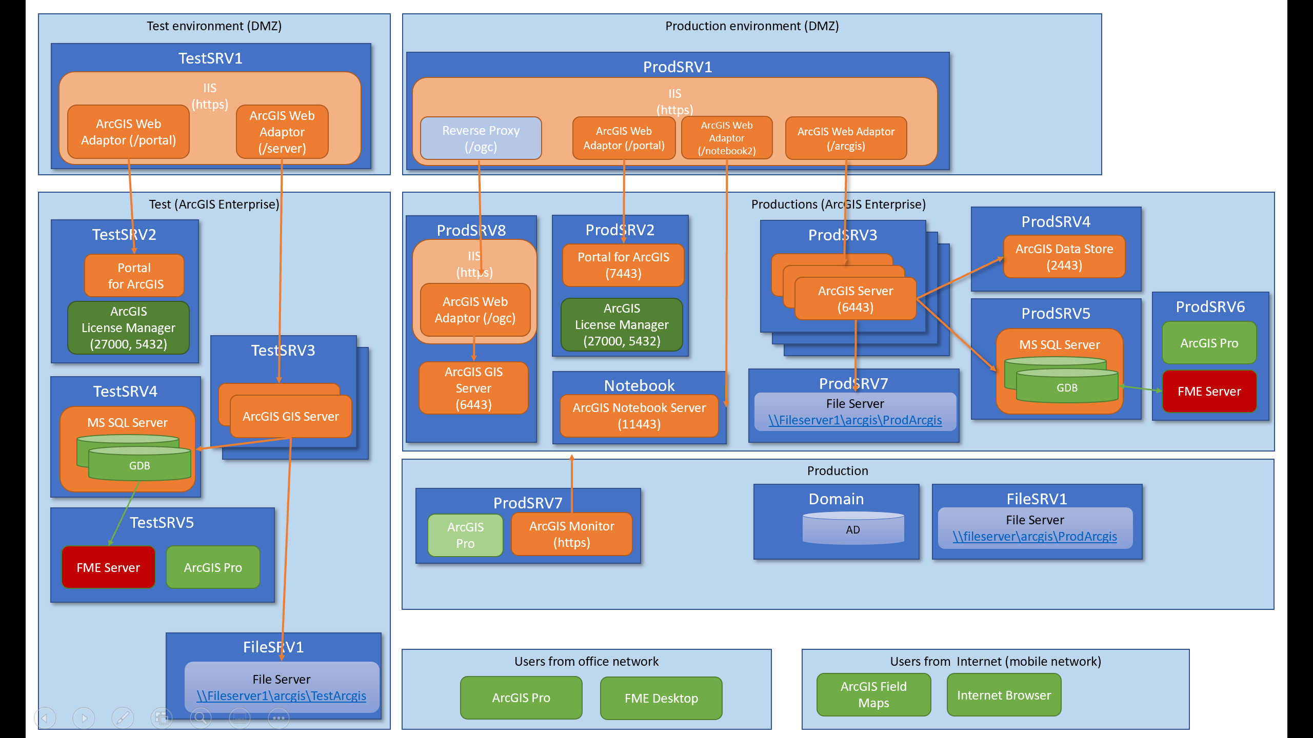

Our ArcGIS Enterprise environment, which runs on version 10.81, consists of a separate IIS Webadaptor Windows server on the DMZ, a Portal, and three robust GIS servers, and an MS SQL Geodatabase server. Attached is a simplified topology image of the Enterprise environment. The portal has hundreds of simultaneous end users on the browser and Field Maps from the public Internet, as well as twenty ArcGIS Pro users in the office network. Where else could we try to find the cause of the fault?

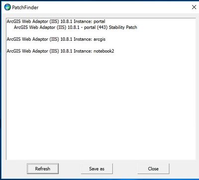

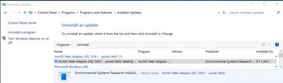

This patch seemed in advance to fix the 'Internal server error 500' error message. I installed it early last month, but unfortunately, end-users still occasionally get that error message. I have now further verified that the patch is installed nicely and Esri's Patchfinder finds it on the Webadaptor server.
We still have to continue hunting for the root cause of the error message and fix it. Good repair tips are more than welcome 🙂

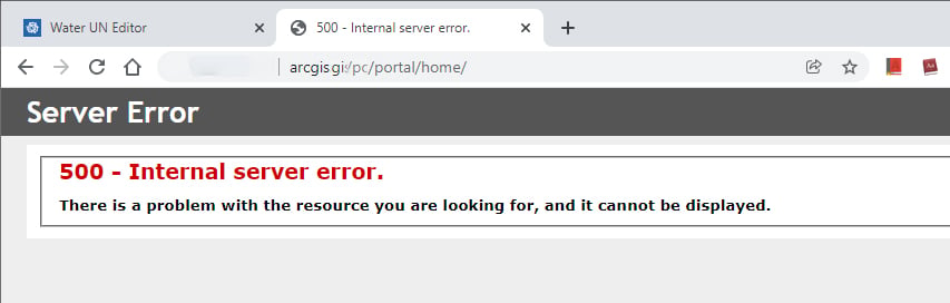

   We encountered this issue after ram memory upgrade. While restarting the server after the ram upgrade, we also did a windows update at the same time. Server Manager was running, the portal service was starting, and a login page in an application I wrote specifically to log in from the portal was returning tokens when I tried to log in. When we typed https://domain.com/portal , it was returning "500 - Internal server" error even if it redirected to /home.
1. I rolled back the updates. Not resolved.
2. I did the Portal for ArcGIS updates but the problem was not resolved.
3. I reconfigured webadaptor.config and other IIS response headers, but it still didn't work.
