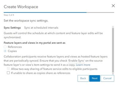

Thank you, I'm in version 11.2 Enterprise and the ability to directly edit interval seems to have changed. Seems like only way for me to change interval is to create a new workspace.
This is what my screen looks like when I try it:
