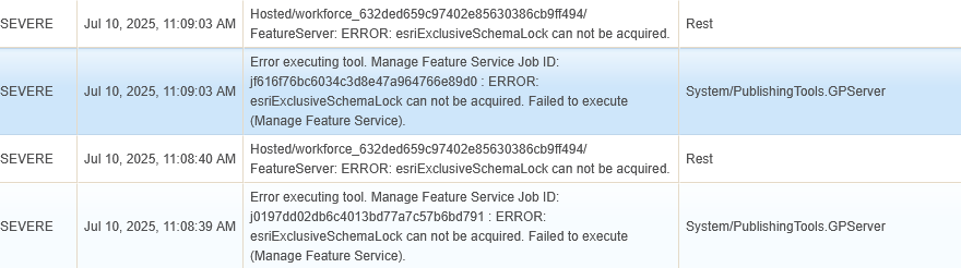

Today, I'm attempting to add a field to a hosted feature layer, that was created when making a Workforce app, so I did not upload this from ArcGIS Pro. This is interacting with the datastore database itself. I received this error here when attempting to add it:
So far, the only documents I see are stating that I need to ensure that I am the only user attempting these changes, and that I need to ensure that the GDB it's stored on when uploading from Pro has its locks cleared, these fit neither of my situation.
What does this error mean? How can I resolve it? This only is affecting a single hosted feature layer, others are perfectly fine, this is a synced and offline mode feature layer that I have added additional fields to before, but not anymore.

Unfortunately, I did not upload this from ArcPro and this is an attempt to add a field to a hosted feature layer  created by Enterprise Portal from the Workforce app.
Cody
