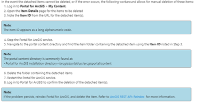

Sorry for the very late response. In the end, I was able to resolve the issue. First, try to perform a FULL reindex of the Portal Content via the Portaladmin API - see if this will resolve the situation (didn't work in my case).
Secondly, you can try to manually delete items in the Portal Directory (be very careful). Find the Alphanumeric ID corresponding to the item you wish to remove, so that you don't remove the wrong content!
Hope this helps😉
