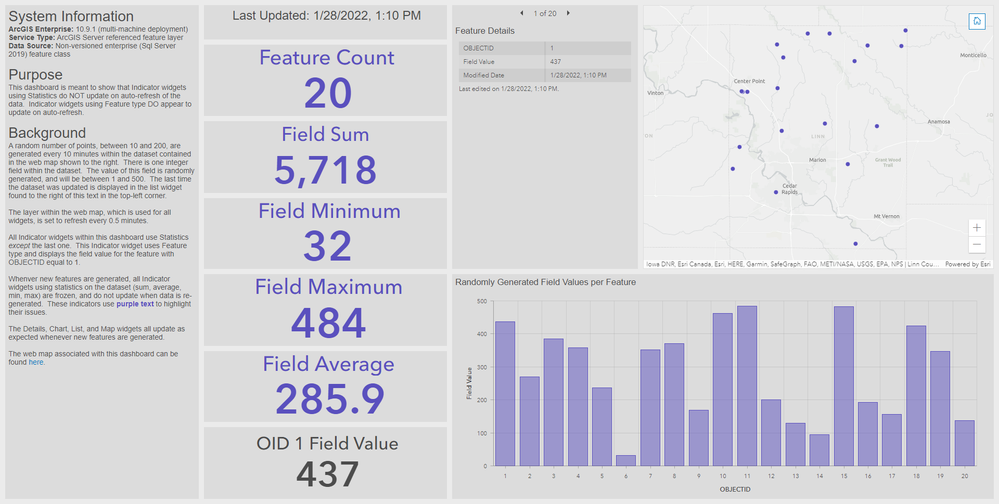

We recently updated our enterprise environment to 10.9.1.  Since updating, we've noticed that any of our dashboards that use Indicator widgets with Statistics (sum, count, average, etc...) do NOT update on auto-refresh of the dataset.  All other widgets, including Indicators using Features appear to update as expected.

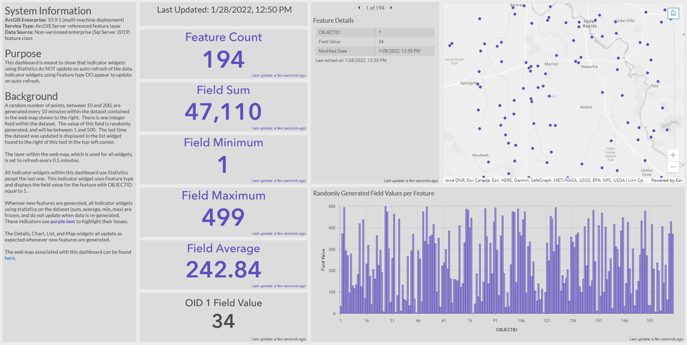

We have created a test dashboard, which can be found here.  A random number (between 10 and 200) of features are created every 10 minutes.  There is one integer field within the dataset that is populated with a random value between 1 and 500.
The indicator widgets with purple text are those using Statistics.  These widgets never seem to update after loading the page.  If the page is left open, the values remain the same, even after data is updated.  The layer in the web map used for all the indicators is set to refresh every 0.2 minutes, and the last update text in each widget shows that it's working because it always says "a few seconds ago".

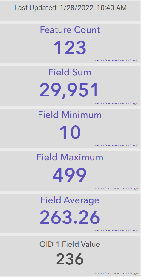

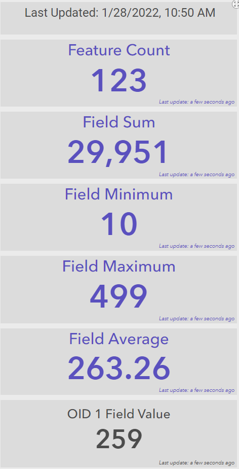

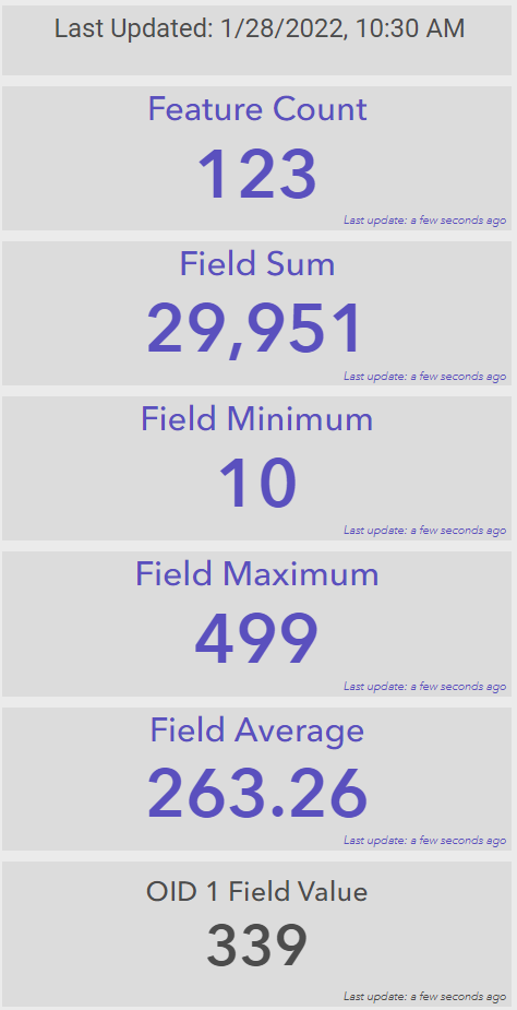

Below are some screenshots to show that the indicator widgets are not updating, and using the source web map for the dashboard, what the values should be.
This was not an issue when we were running 10.9.  Is there any logical reason these widgets no longer appear to work at 10.9.1?  Is it a bug?  Is there a fix?  It's incredibly frustrating that these widgets are not working at 10.9.1.
Data update at 10:30am --- using the Statistics from the web map, the indicators using Statistics (purple text) should display these values.  As you can see, none of them are correct.  The bottom indicator is using Features.  It is displaying the field value for OBJECTID equal to 1, and it is correct.

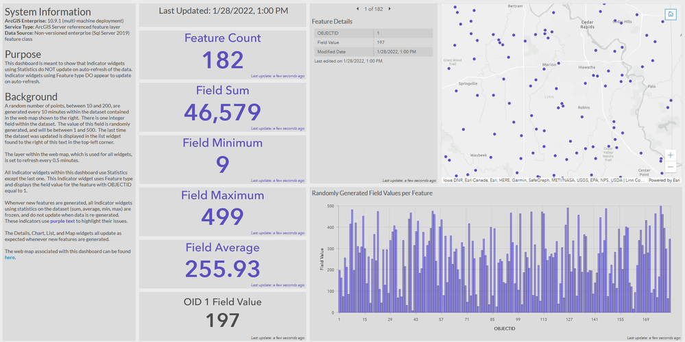

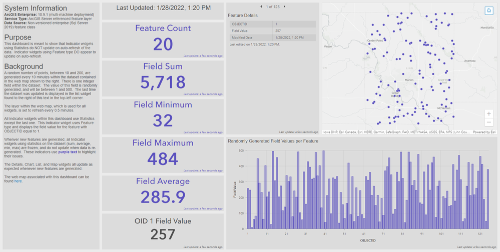

Data update at 10:40am --- using the Statistics from the web map, the indicators using Statistics (purple text) should display these values.  As you can see, none of them are correct.  The bottom indicator is using Features.  It is displaying the field value for OBJECTID equal to 1, and it is correct.  The indicators using Statistics (purple text) remain the same after data re-generation.
Data update at 10:50am --- using the Statistics from the web map, the indicators using Statistics (purple text) should display these values.  As you can see, none of them are correct.  The bottom indicator is using Features.  It is displaying the field value for OBJECTID equal to 1, and it is correct.  The indicators using Statistics (purple text) remain the same after data re-generation.

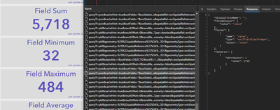

In the network traffic, I can see the various requests being made by the indicators.

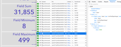

What's interesting is that even the response is wrong. So it's not so much that your indicators aren't updating, they just aren't getting the new data. Here's the same request in Firefox:

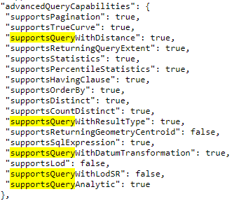

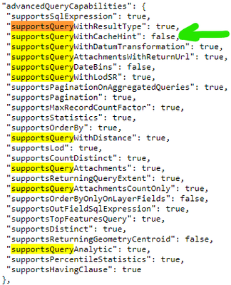

Hmmmm...I don't see "supportsQueryWithCacheHint" listed anywhere in the advanced query capabilities of the feature layer service JSON, shown below.
Is this something that's only supposed to be available for hosted feature layers...?  The service I'm using in the test dashboard (and most of our services) come from user managed data stores on ArcGIS Server, and is not a hosted feature layer.
I do see the "supportsQueryWithCacheHint" property in one of our hosted feature layers, shown below.
Is "cacheHint=true" baked into the request coming from the indicator then?

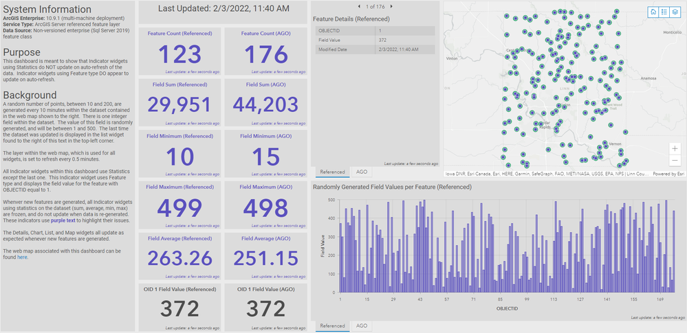

Coming back to this --- the issue seems to be specific to services using ArcGIS Server.  If I used a hosted feature layer in AGO, which contains the same features as those used in our ArcGIS Server service, the statistic indicators update as expected, while those using ArcGIS Server remain frozen.
Indicators using Statistics with purple text in the right column use data from AGO, and update as expected.
Indicators using Statistics with purple text in the left column use data from ArcGIS Server, and do NOT update.
All other widgets (details, map, charts, indicators using Feature type) update as expected using AGO or ArcGIS Server services.
