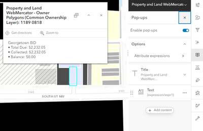

Here's an example of retrieving the related records for a popup.
var rec = First(FeatureSetByRelationshipName($feature, "DCGIS.ITSPE", ['BIDNAME', 'BIDTOTALDUE', 'BIDCOLLECTED', 'BIDBALANCE']));
if (IsEmpty(rec.BIDNAME)) return 'Not a BID';
return `${rec.BIDNAME}
    • Total Due: ${Text(rec.BIDTOTALDUE, '$#,###.00')}
    • Collected: ${Text(rec.BIDCOLLECTED, '$#,###.00')}
    • Balance: ${Text(rec.BIDBALANCE, '$#,###.00')}`
This example is uses a public service, so you can examine how it uses the relationships.
