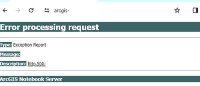

My most recent post about the Token issue is still unsolved, Notebook issues seem unsolvable by most sadly. I'm currently running into an issue where whenever I navigate to /rest/services through my reverse proxy, I am met with a 500 error. This occurs by https://reverse-proxy.domain.com/notebook but on https://domain.local/notebook, it works without any issue.
Top picture is with reverse proxy, bottom is without, I am able to navigate to all other servers on my network, /workflow and /server but /notebook seems to be one to cause issues, as usual.

Try applying a WebContext URL to your notebook/admin/system/properties
https://enterprise.arcgis.com/en/server/latest/deploy/linux/using-a-reverse-proxy-server-with-arcgis...
I suspect this is in place for your workflow and server? I'm assuming that these are unfederated servers?

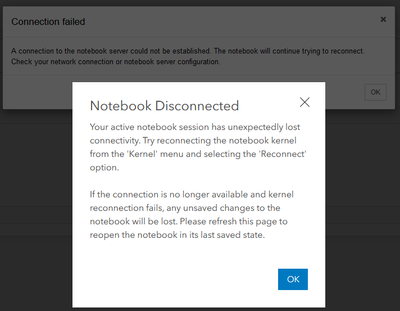

The WebContext URL ended up solving both errors, and it can open notebooks! So that's great progress, but now, as soon as the notebook opens, it states "Notebook Disconnected" immediately, and it is unable to connect to the Kernel from then on.
For the other questions, Workflow and Server both do not have the WebContext URL configured, but they are working as normal, all three of these servers are federated currently, to get the Notebook to almost work, I had to refederate under the new WebContext URL.
Any ideas on the Disconnections?

Have you validated that docker is accepting connections and is healthy? $ sudo docker run hello-world
should validate the installation for you, it may be a case of ensuring the appropriate ports are open. Good way to test is to jump on the Portal machine and browse to the endpoint required for notebook server.
Suggest you switch the Notebook server logging to debug and then follow the error instructions i.e. reconnecting from the kernel menu - hopefully, that lets you know what's going on.

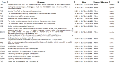

Thank you for the response and suggestions, running the docker hello-world I get the "Hello from Docker" message showing everything is successful. I am able to browse to the endpoint without issue on the webcontext and without webcontext. Something that support techs haven't tried yet is the debug log settings, and I found it was quite useful! I'm not entirely sure if it explains what's going on though, this is what I see:
Hope that leads to some insight!
A_Wyn_Jones
@CodyPatterson Everything in that log looks good - with the exception of Esri Notebook samples missing (not an issue).
I suspect that it's working? Since it's a distributed deployment, I'd suggest you check that you have SSL certificates for the notebook server.

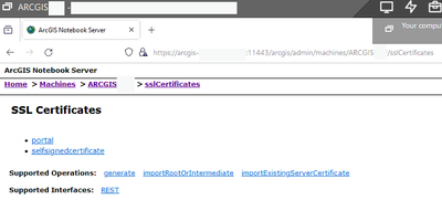

Here's what I'm seeing in the admin portion of the Notebook server, I did notice that this is the only server that somehow doesn't have a .domain.local at the end of the machine name, it just has <machinename> rather than <machinename>.domain.local.
We were told that we should cross-polinate the SSL certificates with our portal, and along with that, it would be fine to have a self-signed certificate present since we use a reverse proxy to redirect the traffic.
Also no hosts file or DNS entries are present on internal or external DNS servers.

Have a look at SS14 in this table: https://enterprise.arcgis.com/en/server/latest/administer/windows/scan-arcgis-server-for-security-be...
Generally, it is highly recommended to swap out these selfSignedCertificates for CA signed ones where possible - this is to stop unexpected behaviour and to appease internal security scans.
The Admin URL found in 11443/arcgis/admin/machines/ARCGIS is the URL that should have SSL (you can apply cert through the SSLCertificate endpoint). Hopefully, this URL is fully qualified for you i.e. contains .domain.local.
If you've got all that setup and you're still seeing issues - I'd suggest you raise a support ticket. At least now we've put your system "on solid ground" for the support call.
