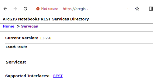

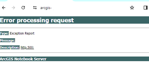

My most recent post about the Token issue is still unsolved, Notebook issues seem unsolvable by most sadly. I'm currently running into an issue where whenever I navigate to /rest/services through my reverse proxy, I am met with a 500 error. This occurs by https://reverse-proxy.domain.com/notebook but on https://domain.local/notebook, it works without any issue.
Top picture is with reverse proxy, bottom is without, I am able to navigate to all other servers on my network, /workflow and /server but /notebook seems to be one to cause issues, as usual.
