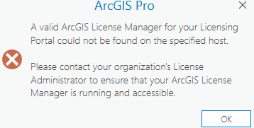

Hey All,
Enterprise 11.2, License Manager 2023
I was curious if anyone has experience connecting to their license manager through a reverse proxy? We have a public site that our employees can connect to the portal URL through, we were hoping that they would be able to use the portal URL through the public portal and connect, but I'm getting this message here:
Our license manager is up and running, I'm able to connect on the network, but not over the public address.
Any thoughts to this?

The portal part of the license manager is on HTTP/443 via the Reverse Proxy.  But then it forwards the requests to the FlexLM license manager on a port that is not HTTP.
For this reason, and to avoid complexity/opening up firewalls, I typically recommend clients to get their licenses from ArcGIS Online.  If an organisation is 'secure' and can't use AGOL for licensing, then it typically suggests that the firewall issue won't be a problem and the FlexLM port will only be needed internally.

Thank you for the response, I was curious if it may have been the port that it is working through, I was under the assumption that once made through 7443, it would then work through 27000 or similar to get to the license manager right off the portal. I'll allow 27000 through just to see what happens.
I agree that it would be complex and insecure to open up the firewall to any further ports, but we'd like to attempt and move away from AGOL licenses for the most part, but if that's the move, then we'll go that way!

Check out Bill's comment below.  I believe you'd need 27000 and 5152 on your external firewall based on that.

Just one other thought on all of this.  A lot of the environments that I get to interact with have different zones.  By which I mean, the internet comes in on 443 (and your new ports).  This routes to the web server.  That then routes through an inner firewall to the application server on 7443.
If you're zoned like this, then remember that your inner firewall ports will need to be opened as well, and you'll be effectively routing from the internet to your application zone.  There may be better ways of dealing with this, but it will come down to what's in your IT kit bag to allow it....

I spoke with our network administrator, and I mentioned checking the certificate on SSLLabs, we did so and found that it had been revoked. Thankfully he had the ability to reissue the certificate, so we uploaded a new CSR and got it reissued, and boom, everything started coming through as normal. We're able to access the License Manager both on and off network. What gave me the hint was that Field Maps stated the certificate was untrusted, even though there was no warning when navigating.
