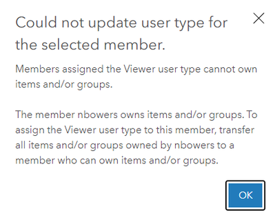

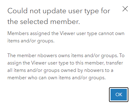

I'm running into an issue where I cannot change the User Type for an account in Portal (v 10.9.1); a task I've done many times before with no problems.  But this time I am prompted with the message: "Members assigned the Viewer user type cannot own items and/or group."
Cool, I get that; make sure the user owns/hosts nothing.  But here's the thing, the user owns no items, not the owner of any groups, nor is a member of any groups, and has zero add-on licenses.  What gives?  Do I have to delete this account to even make some basic changes?  I'm tempted to pursue the delete option as this is a dev environment, but this is frustrating as a admin when simple changes don't work and are NOT consistent.  Plus I would not want to delete a user in production as this causes a whole host of problems ...

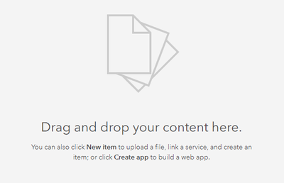

Brownschuh_1-1711116724441.pngBrownschuh_2-1711116747381.pngBrownschuh_3-1711116766203.png

Ok so I was lucky and was able to change the user type without having to delete the user.  Here's what I did:
  • Went to Portal rest endpoint (https://webadaptorhost.domain.com/webadaptorname/sharing/rest) and logged in with an admin account.
  • Clicked Users at the bottom of the page and searched for the troublesome account.
  • Clicked on the User Content button and discovered there was some code that the user still had attached to their account.
  • Clicked Delete Item button.
  • Navigated back to the Portal site > Organization > Members > selected the user and changed the User type from Creator to Viewer (plus the Role).
Thank you for pointing me in the right direction; somehow I was not aware of that Portal rest endpoint site.
