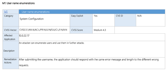

I want to share with you our cybersecurity team concern about user name enumerations for the directory of /portal/sharing/rest/community/users/(The name of the user),
we want to deploy our portal to be accessed from outside the local network but the cyber team did a penetration testing before authorizing posting the site on the internet.

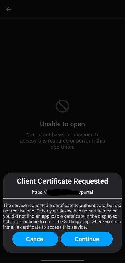

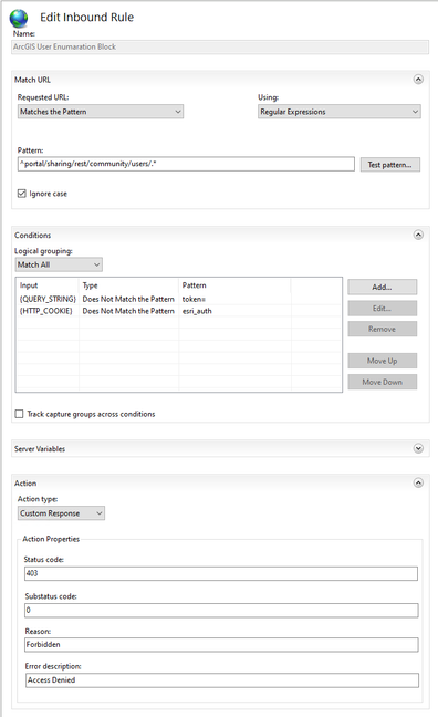

We would like to lock anonymous access so the user names cannot be found by this method we have tried to create a rewrite rules by setting conditions to be met when trying to access the directory it works with the portal it self but not with ArcGIS pro the app crashes when trying to login, And ArcGIS field maps faces a problem after the login regarding the certificate, when the rule is disabled everything works normally.
Here is the report about the penetration testing
Penetration testingPenetration testing
Url rewrite Rule
Rewrite RulesRewrite Rules
ArcGIS Field Maps Error
ArcGIS Field MapsArcGIS Field Maps

The only way that we tested and worked is through a proxy where when the directory /portal/sharing/rest/community/users/ is triggered you make a rule to redirect to 403 Forbidden Access.
So far the rule is working well with ArcGIS Pro and ArcGIS Field Maps.

Unfortunately it is possible to try different user names in the mentioned directory until you find an existing user without the need to be signed in, our cyber team didn't have any user names given to them and they gave us a screen shot for the information regrading the user, and there is no option in the portal that can prevent it.
