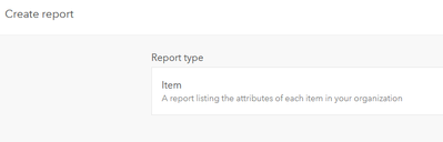

I am interested in conducting an inventory of all our content items in Portal in an effort to clean up content. Is there a way to download a spreadsheet listing all content found in our organization?
jcarlson
MVP Esteemed Contributor
What version are you on? You can go into Organization → Status → Reports to create an Item report with details about all content, but I believe that was added in 10.9.

DavidMieksztyn
Thanks Josh, we are running 10.8 still. This is good to know though when we upgrade!
