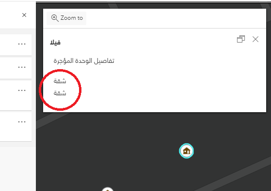

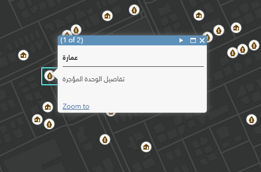

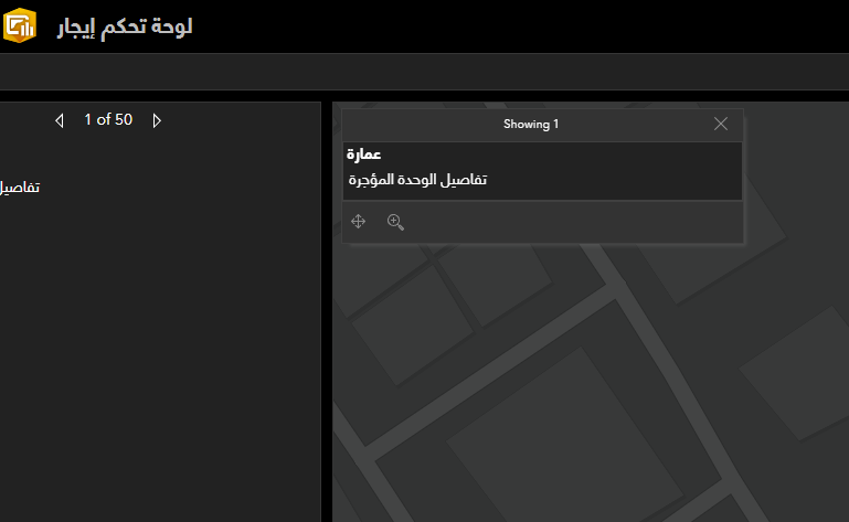

I have a problem to viewing my custom pop on  Esri enterprise online despite it is work on map viewer beta  please see in below ....
It is working on (   map viewer beta       ) as picture in below
But it did not work on ( Map Viewer classic ) and ( dashboard) as pictures in below
