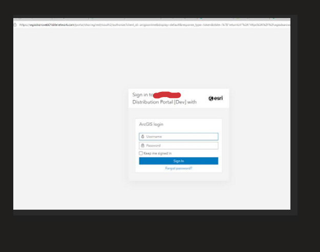

I'm building a dashboard that will have a layer I want users to be able to search on. The Dashboard and all its layers are set to public so anonymous users can access it. I've added the layer I want to search on to the searchable layers option in the map settings and I am able to search on said layer in both the dashboard and the map layer itself.
I've successfully shared the URL with users in the company who do not have ArcGIS accounts and they are able to move around in the dashboard. However, when they try to access the search bar they are sent to an ArcGIS login screen, of which they do not have.

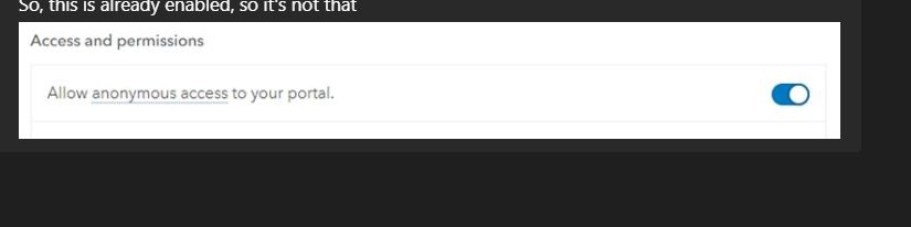

The Allow anonymous access to your organization toggle is set to enabled.

The issue occurs even when a completely empty map with no layers is shared by the admin to an anonymous user, they are still prompted to login.

That usually means your portal's default locator isn't shared publicly.
