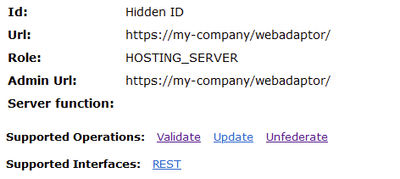

I attempted to research this, but most of the time it's due to an incorrect services URL, but mine are correct, as shown:

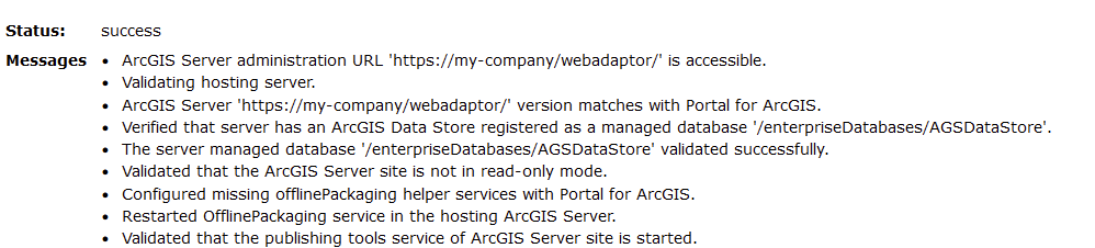

Validation shows correct as well:

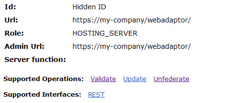

Should have attached the URL, this is what I am seeing:
