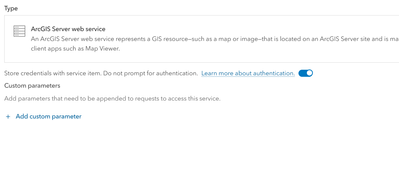

I wanted to add I'm still trying to find a solution here. So I am able to register the service but it will fail when I try to store credentials is toggled on (see image attached)?
So when this is toggled off it registers correctly. But then when I use service I get prompted to sign in which I don't want.
