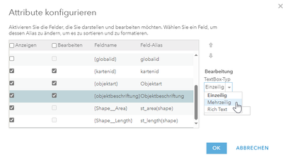

Hi, I´m trying to configure a multiline Text Box for an Attribute in my Feature Layer in ArcGIS Portal 10.9.1. In Map Viewer Classic, this works smoothly by choosing the desired TextBoxType (mehrzeilig=multiline)

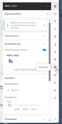

In the new Map Viewer, this option is no longer availabe.
In ArcGIS Online and later versions of AGE this function is available in the Layer Properties Section of the Webmap and the function "forms".

I am using Feature Services in the WebMap. I checked the Topic you mentioned, but it was about labeling  features, and mine is more about configuring the attribute field in a way that it can hold more than one line.
