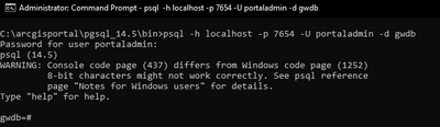

1.  Open command prompt
2.  Change the directory to portal's PostgreSQL bin directory.  Ex:
c:\arcgisportal\pgsql_14.5\bin
3.  Connect using the initial Portal Administrator username/password when portal was installed:

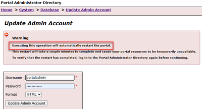

If you do not know the username/password, this can be updated through Portal Administrator Directory > System > Database:

Hi @JakeSkinner
Good day!
May I know if there is any downtime we can expect once we change the password and does it affect anything on the Portal/ArcGIS Enterprise itself? Etc: services restart/crash
I am looking forward to hearing from you.
Regards,
Iqbal
JakeSkinner
Esri Esteemed Contributor
@IqbalRidwan yes, the Portal service will restart:
