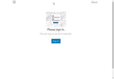

Is it possible to customize the login page for an Enterprise Portal Site?  Right now it's pretty basic and we'd like to provide our users something a bit more intuitive.  Here's a screenshot of the basic login page:

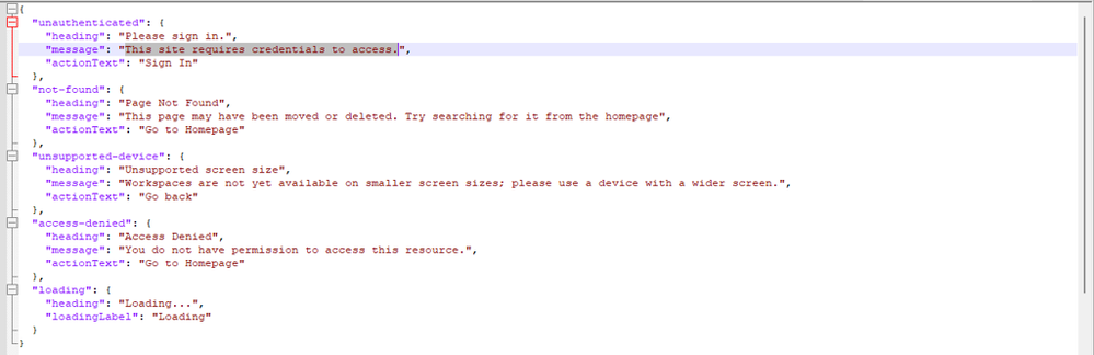

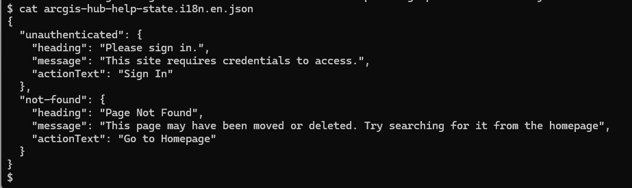

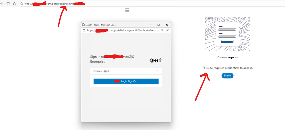

Hello @Andrew-Bowne
Windows:
C:\Program Files\ArcGIS\Portal\apps\sites\stencil-components\locales\arcgis-hub-help-state.i18n.en.json
Linux:
How to find on a 11.5 and 11.3 version of Enterprise Portal (or any other version of the software) :
  • Use Notepad ++
  • Ctrl + F
  • Find in Files tab
    • Find What
    • Directory
Maybe some day Esri will provide us with a supported workflow for this?
@DerekLaw https://community.esri.com/t5/arcgis-enterprise-portal-questions/is-it-possible-to-customize-the-log...
@MaggieBusek https://community.esri.com/t5/arcgis-enterprise-ideas/customizable-portal-sign-in-page/idc-p/1342819...
