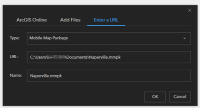

As in the image below, Arcgis Earth does now show the maps.
I could only see the MMPK by downloading them on my pc and then adding them to Arcgis Earth. Is this the only way?

If the MMPK is not supported yet then I think ESRI should remove from Earth "Add Data" panel the data type "Mobile Map Package", because if ESRI leaves it there it seems like it is supported!

I guess you are talking about the 'Add data - Enter a URL' panel. We do have data types like "MMPK" in the dropdown list. Though we usually use network resources here, the local path is also accepted.
Earth supports all the data formats listed in the 'Type' dropdown, and we recommend users add some files in a local way. We have already noticed that users might be misunderstood here. Some enhancements will be coming in the next release to eliminate the confusion.

Yes, this is exactly what I was talking about, that is why I was confused.
Now I understand this link refers to inserting a local path.
