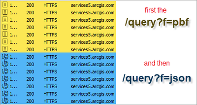

Beginning at version 2.1 (we haven’t tested 2.0), our ArcGIS Online users have been complaining about very slow response times when consuming AGOL Web Maps. The drawing response time seems to be a tiny bit better with 2.4, but the querying response time is still painfully slow. In this example, it takes some 30 seconds for the popup to show up.
It seems that all the features must be completely drawn before any popup could be treated. Doing some investigation with Fiddler, we found out that the queries for the popups (/query?f=json) always seem to be treated after all the other queries that return PBF data (/query?f=pbf).
Is there a reason why the calls are treated in that strict order? Could the popups be prioritized over the drawings?

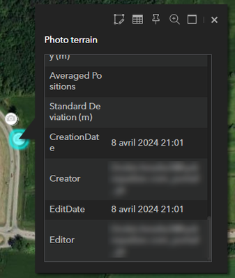

I first tried to add individual feature services from their ArcGIS Online item ID (https://xyzxyz.maps.arcgis.com/home/item.html?id=xyzxyz), and it was the same slow response time (even with services that contain only a few layers).
I then tried to add the same individual feature services from its REST URL (https://services5.arcgis.com/xyzxyz/arcgis/rest/services/xyzxyz/FeatureServer/), and then the time response was better.
But we cannot use the REST URL, because the attachment files (like pictures taken with Field Maps) are only visible if we use the itemID.
  • Popup shows the attached pictures when itemID is used :
  • Popup won’t show the attachment if REST URL is used :
*the hour in the date is also wrong because of a time zone issue
