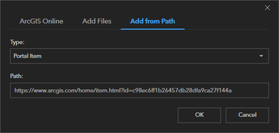

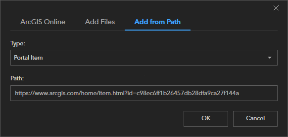

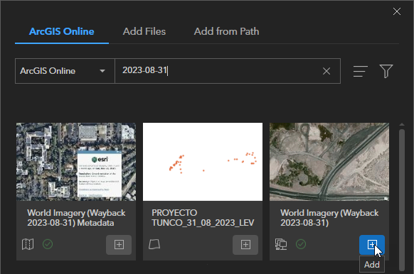

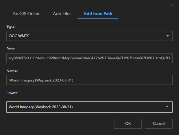

I know 3 ways of doing this manually.
From the ArcGIS Online tab :
From the Add from Path tab, Portal Item type :
From the Add from Path tab, OGC WMTS type :
