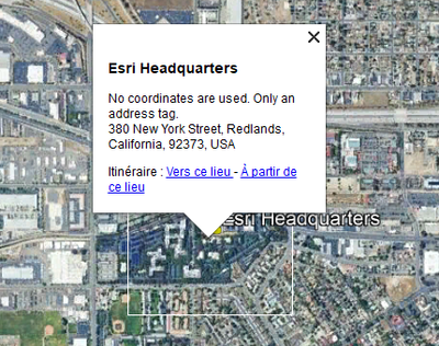

And the result in Google Earth EC :

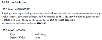

The OGC KML 2.3 standard states this about the <address> tag :
It would be great if ArcGIS Earth could also make use of the KML <address> tag.
