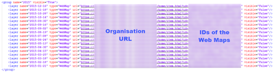

We added the World Imagery Wayback WMTS layers and its metadata in our ArcGIS Earth organizational configuration, but it requires a lot of time and clicks...
  1. Reference the WMTS layers in Portal or ArcGIS Online (https://wayback.maptiles.arcgis.com/arcgis/rest/services/World_Imagery/WMTS/1.0.0/default028mm/MapSe...)
  2. Create a Web Map for each WMTS layer you want to use. In them, add :
    1. The referenced WMTS layer
    2. Its associated metadata (example : https://metadata.maptiles.arcgis.com/arcgis/rest/services/World_Imagery_Metadata_2014_r01/MapServer)
  3. Incorporate the Web Maps IDs in your organizational configuration file. Example :
