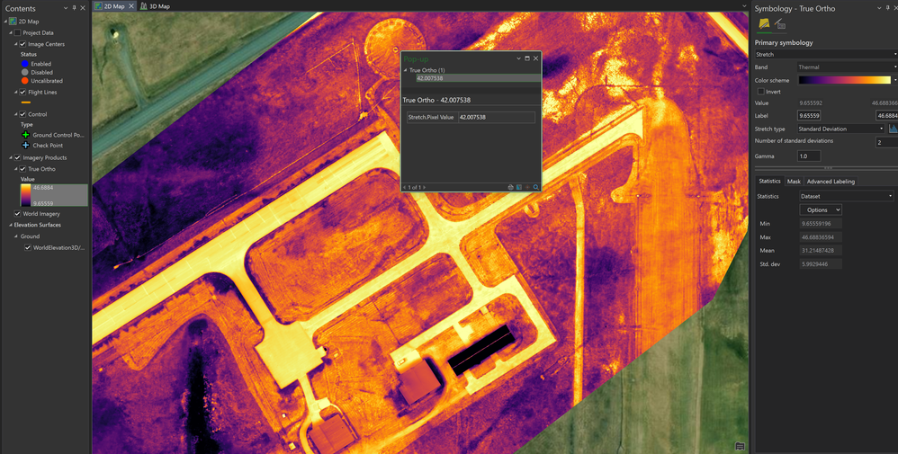

RockRunEnterprises
I flew the route again today. Reinstalled the sdk and processed successfully. I used the white-hot palette on the camera for what it's worth.
Question, is the data represented in Celsius? I'll have to do a conversion of the raster for F.
