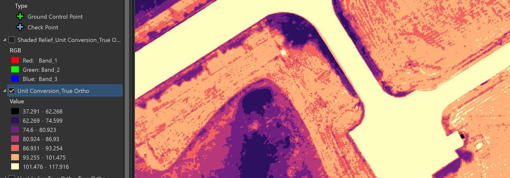

Definitely in C, converted to F with Raster Functions "Unit Conversion" in Pro.
Awesome results. Thanks for the effort @CodyBenkelman
