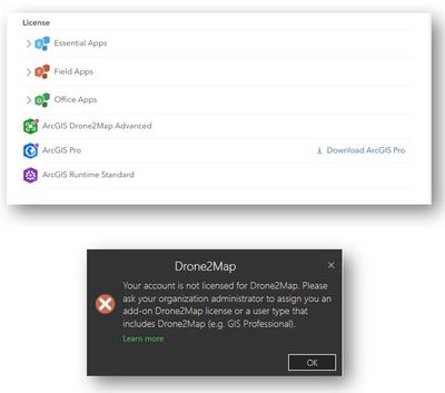

I have a D2M license via my AGOL account just like my Pro license (as shown in the screengrab), but when I launch the D2M I'm unable to launch due to the prompt saying "not licensed" (see screengrab). My organization hasn't used D2M in over a year, now we have a project that we need to process and I just can't figure out how to solve this. I'm hoping someone has experienced something similarly and solved it! Thank you in advance.

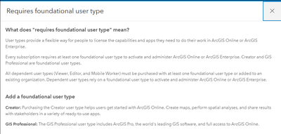

Please also check that you are on one of the foundational user types required, Creator or Professional.

Thank you for the info. We ended up uninstalling the old version and installing a newer D2M file. That seemed to fix the problem for us.
