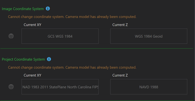

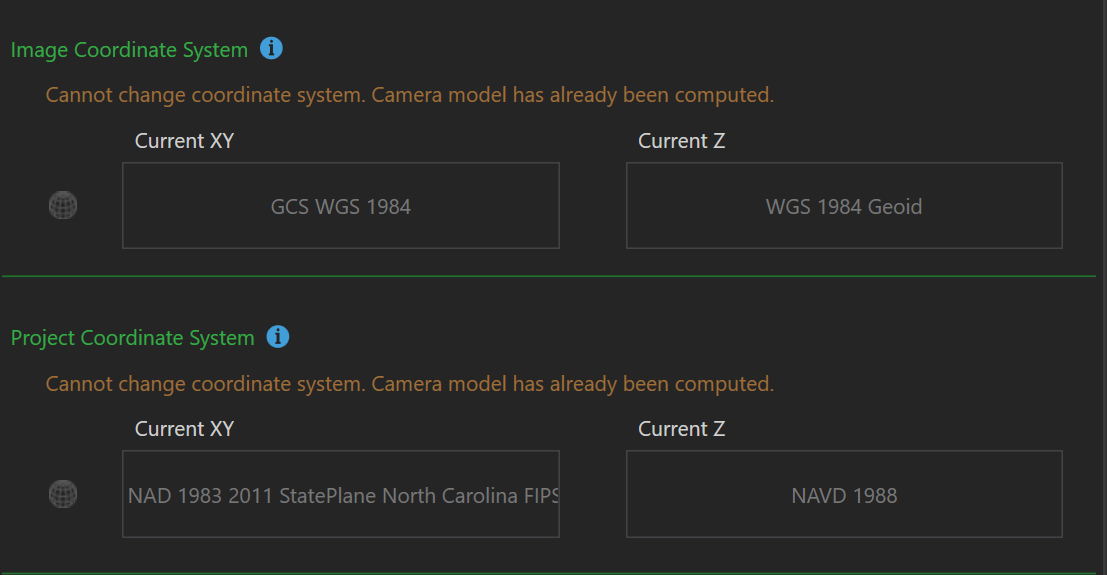

Hi! I am new in Drone2Map and need help with image processing. I have processed my images and got the wrong elevation in my DSM/DTM. I tried different coordinate settings. For example, the altitude of the processing images is about 98 meters and the value of the DTM is about -5 to -20 meters for these settings:

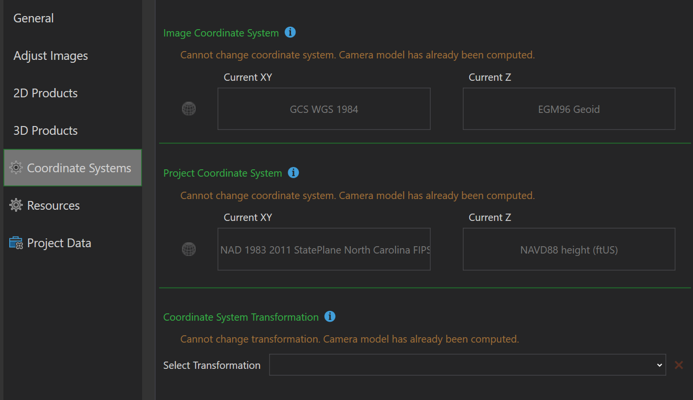

Another example: DTM elevation from -11 to -61 USft for these coordinate settings.

If you have a drone without RTK or PPK GPS you will have to use the GCP's to arrive at "correct" heights, as the recorded XYZ are "far off" or more correct; with code-GPS precision and z possibly relative WGS84 ellipsoid.
If you do use RTK/PPK it might be a height-transformation you are missing - and/or the drone height reference is mismatching the settings you use in Drone2Map. For many height transformations you might need to install the "ArcGIS Coordinate Systems Data" which you will find in My Esri together with the Drone2Map installation package.

You said "The ground-controlled points are not applied" but you didn't include any details.  Since your project coordinate system is State Plane, I am guessing you might have used GCPs but they didn't work properly?
Pål_Herman_Sund also gave good advice  regarding the vertical coordinate system - whether RTK/PPK or ground control points, check to see if they might be referenced to ellipsoidal height.

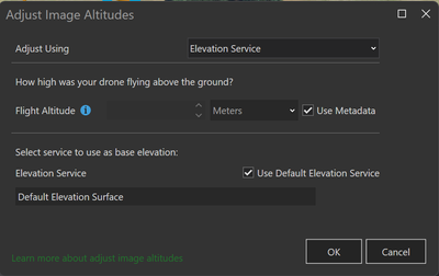

VarvaraVedukhina

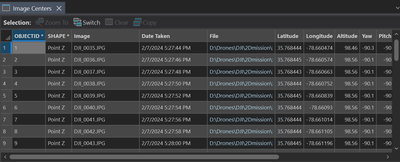

I am not sure, but it looks like the information in my images contains the altitude above the ground. The orthometric height of the territory is about 96 meters, and 98 meters was in the altitude field of the image table, my drone flew at an altitude of 89 meters according to the waypoint. After adjustment with the parameters below, I've got an altitude of about 180 meters, and the DTM looks more correct: 3 meters different from the base map elevation. What do you think about this?
VarvaraVedukhina
Okay! I think, that I solved the problem. I have adjusted the image altitude because it was above the ground. After adjustment, the elevation of the DTM looks better (corresponds to the default elevation model at list). This is what I needed.
