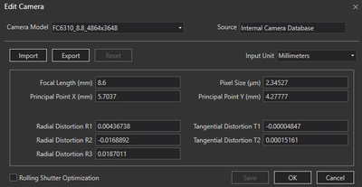

You might try selecting the Rolling Shutter Optimization option in the Edit Camera settings.  You can also try in the Processing Options -> Initial, select the Use Geometry Verified Matching.

Thanks for the reply. I have had the rolling shutter option selected, might have gone away when I went back to the defaults, but I believe its elects it based on the camera information. I will check it and try your other suggestions.

Thanks for all the suggestions. I did bump up the overlaps to 80-70%, but I will try the 85-80%, and went back to the lawnmower pattern. The rolling shutter is selected, I'll look into the suggestions, but I don't believe I can control the seam lines.
