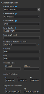

After reviewing the dataset we found that the camera model was not supported by default within Drone2Map (Autel Evo II Pro version 2). Because of this the image metadata was used instead to attempt filling in the camera parameters. This resulted in no focal length being added and an erroneous value used for all coefficients.
Default values for this camera model have now been added to Drone2Map and will be present in the next patch. Additionally, a check has been added to make sure that dewarp values are valid.

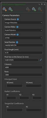

The original issue has been resolved. The problem was a combination of the regional language pack Faroese (Denmark) and issues with importing metadata from the specific drone camera (DJI Mavic 3 Enterprise). When the Regional format in Windows was set to Denmark the camera values were not importing correctly.
Setting the regional language to English does not reproduce this issue.
When cameras do not have default camera values in the camera database Drone2Map will attempt to import the values from the image metadata. This is something that is not always accurate as different drone manufacturers can have slight formatting changes or even erroneous values. It is good to double check and make sure that the values appearing in the Edit Camera pane make sense. Importing from image metadata is a function that was added in the 2023.1 Drone2Map release and we are continuing to improve upon it.
