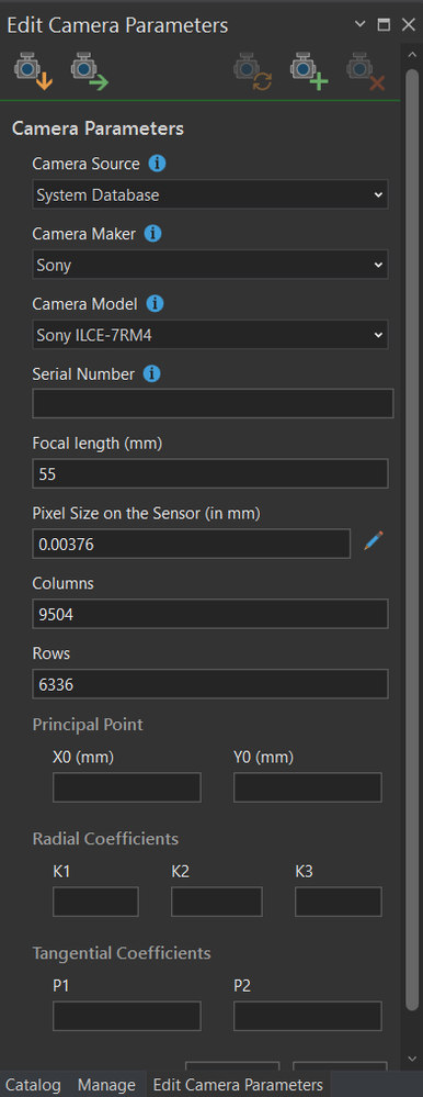

Hello, I'm also having the same error and using a Sony camera on a Skyfish drone. Attaching the camera parameters for info. Screenshot 2023-06-19 110747.png
PeterLarsen
Try to change the focal length to 0.55 mm and process everything again.
