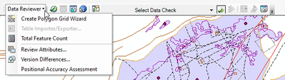

Hi Jay and all.
We are looking for the ArcMap "Positional Accuracy Assessment" tool in ArcGIS PRO: does it exist somewhere, or is there a new way to reach the same result?
Here in Colombian Mapping Agency (IGAC Bogota) it is highly used for orthoimage control and validation, and so the team does not want to shift from ArcMap to PRO without solution.
We are currently conducting a review of what is where from ArcMap to PRO as they widely use Data Reviewer.

JayCary
There are currently no plans for implementing the Positional Accuracy Assessment Tool (PAAT) in ArcGIS Pro as it was a rarely-used tool in ArcMap.
If this tool is critical to your workflow I would suggest creating an idea in the Data Reviewer Ideas place (https://community.esri.com/t5/arcgis-data-reviewer-ideas/idb-p/arcgis-data-reviewer-ideas) to identify how your organization has been using this tool in ArcMap.
Thanks!

Nicolas_GREHANT_IGNFI
Could you please also confirm what exists or not in PRO from the ArcMap Data Reviewer toolbar:
  • "Create Polygon Grid Wizard" : replaced by "Create Fishnet" geoprocessing I suppose.
  • "Total Feature Count" : anything to get the same quick result including export to CSV (except scripting it)?

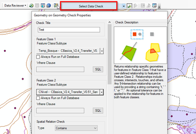

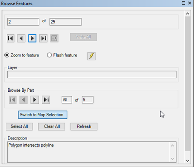

And for all "Select Data Check"? compulsory now to implement them as Attribute Rules meaning adding Global ID and Editor Tracking (which modify our GDB data structure)?
That was very convenient in ArcMap to use them without creating cGlobal ID and Editor Tracking fields, and to be able to browse them when needed.
