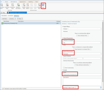

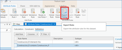

Hi all.
After having created two simple Feature on Feature Validation rules, I have exported them (CSV). Unfortunatly, trying to load them drives to crash.

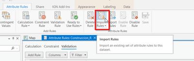

Anyway taking a break I thought, "could I test it through arcpy?". And in fact I did it, and it worked, through Geoprocessing ("Import Attribute Rules").
The crash occurs when I try to import through Attribute Rules GUI (Import button in Attribute Rules menu).
