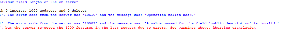

ArcGIS Portal Feature Service Writer: 'updateResults' error for a feature in 'gid_stormwater_1'. The error code from the server was '10510' and the message was: 'Operation rolled back.'
... Last line repeated 568 times ...
ArcGIS Portal Feature Service Writer: 'updateResults' error for a feature in 'gid_stormwater_1'. The error code from the server was '10583' and the message was: 'A value passed for the field 'public_description' is invalid.'
ArcGIS Portal Feature Service Writer: 1000 features successfully written to 'gid_stormwater_1', but the server rejected the 1000 features in the last request due to errors. See warnings above. Aborting translation

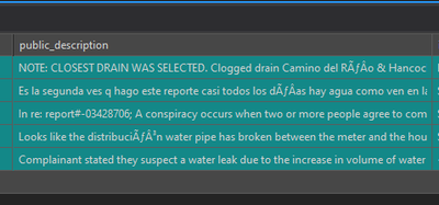

I was guessing it could be something to do with some accented characters in the public_description field, though I do see these characters successfully published to Portal when published manually.

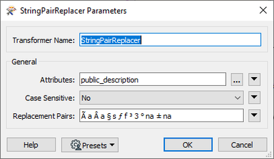

I tried using a StringPairReplacer to swap these out, but either I'm not getting them all or it's something else.

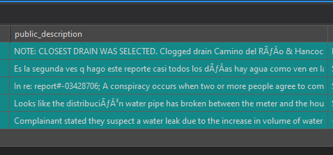

Here is the public_description field of this record:

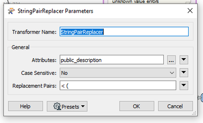

If I remove the < bracket with a StringPairReplacer, the translation is successful. If I remove only the > bracket, it still fails:
Interestingly there is a second record with a single < that causes no issues:
