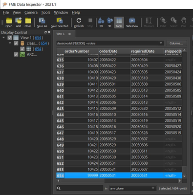

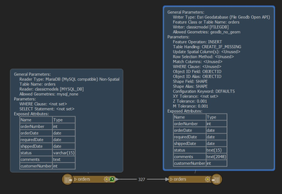

Just tested Data Interop 2.8 using the classicmodels sample database from MySQL and all features from the orders with null ship dates were written using the filegeodb writer.
No records were dropped. I ran the workspace twice and inserted the features twice.
Here's a screenshot of my workspace.
