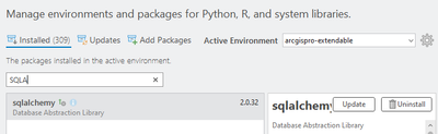

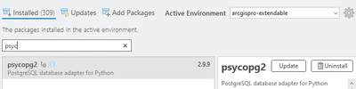

Following your advice on how to install additional Python modules to use them in the Data Interoperability Workbench I installed SQLAlchemy and as a dependency also psycopg2.
Here the screenshots from ArcGIS Pro where the active environment and the packages in question are shown with version numbers.

the necessary packages confirmed to be installed in the clone of ArcGIS Pro Python environment,
and the clone is set as the active environment.
