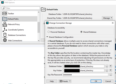

Just learned this in Pro 3.4 recently. A more secure and easier way to secure shared connections that can be used for your shared workspace.
This is configured in FME Options --> Default Paths

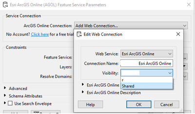

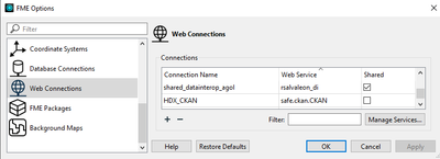

When you implement in your workspace you can toggle Shared in the Visibility drop down for the web connection.
