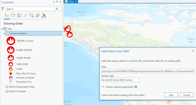

If you use Pro, using the feature service URL add the layer into a map (below), then use the Features to GPX geoprocessing tool to create a GPS Xml file with .gpx extension.
If you want to transform your data or write to a different GPS format then Data Interoperability can come in handy with that.
