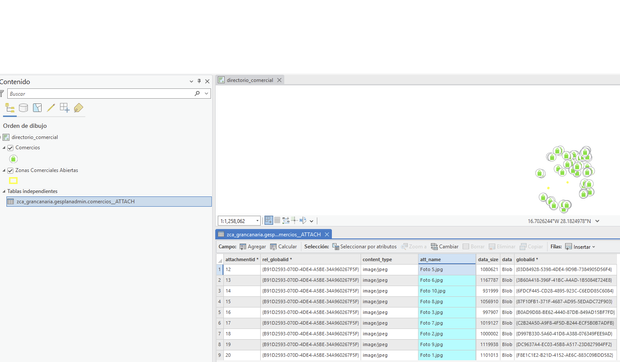

I have in my virtual machine this project.
I can change the "att_name" and replace "Foto1"(default name) for "Escaparate", replace "Foto2" for "Fachada", etc.  ("Foto1" is not always "Escaparate" or "Foto2" is not always "Fachada" / It depends on the order thath de field worker took the photos.)
But isn't my work. This task must be done by the technicians responsible for thath project.
I am looking for a tool (like Web app builder, field maps, Experience builder)  that allows to change this attribute of the attachment table.
