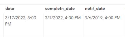

Example from data cache before publish to Portal:

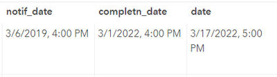

Data published to Portal, in UTC:

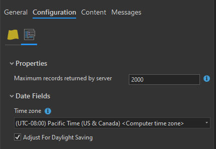

So I then tried publishing the feature service first using ArcGIS Pro 2.9.2, and designating the Time Zone setting at time of publishing:

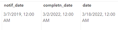

The initial publish is correct:
After running my Data Interop workbench to update the layer, the data appends in UTC:
