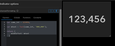

You'd need it to read
middleText: Text($datapoint.numbers, '###,###')
 Personally, I prefer to do any manipulation of objects and variables outside of the return statement. That way if something's not working, you can try to debug it easier. I tested this in an indicator, and it does seem to be working. I'd double-check your expression.
var some_int = 123456;
var mtext = Text(some_int, '###,###');
return {
    middleText: mtext
- Josh Carlson
Kendall County GIS
return {
    middleText: mtext
- Josh Carlson
Kendall County GIS
Ade_Bruijn
For the users who prefer the .(period) as separator. Arcade needs , (comma) and (if I'm not mistaken) your organisation settings return a .(period)
