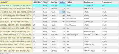

I had test data laying around so I used  that and wrote an attribute rule to populate a new field named "Predominent" (spelled wrong) with the predominant value from the TextTst field (in the image below I updated the IntTest field from 6 to 7 to fire the Arcade to populate the Predominent field)
The expression I used uses OrderBy (DESCending) to order the feature set returned by the GroupBy function in descending order from most to least occurrences of COUNT.  The First function just takes the first record from this ordered feature set.
The only problem is if you have a tie its only going to take the first one.

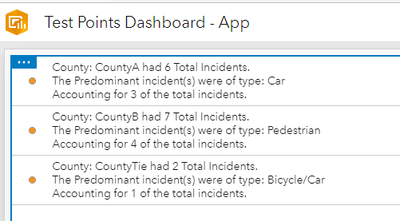

I generated this List:
I learned a bunch so thank you for the question.
