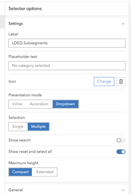

MarkGambordella
That is exactly what I was doing.  I changed it to feature and is working as should.  thank you!
there is a tab within the Selector Section for single or multi.  but that will only select multiple polygons within that layer.  not sure how to filter is with multi polygon from different layers at the same time.
