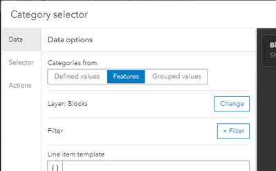

These two layers are in separate feature layers. They are not related. That's why I've set up a spatial filter. I noticed however that the numbers in the indicator widget and list widget are showing incorrectly. Nothing should appear there. I turned flash on in the map and realised the spatial filter was filtering as a rectangle, so it is picking up neighbouring data and loading that into the indicator and list widgets when in reality it should be populating the indicator and list widgets.
Is there a way to set the spatial filter to the exact extents of the polygon in the selector drop down, not a generalised rectangle?

If anyone else runs into this issue, I had the Selector category to Grouped values. That was the issue. Once I switched it to Features, it was all sorted.

I need to know how to use the spatial filters on group values as well.  When I use the features category I can use the spatial filter to show a count of points within the polygon, but when I use grouped values, the count is incorrect, as it seems to use the envelope instead of the actual polygon boundaries.
