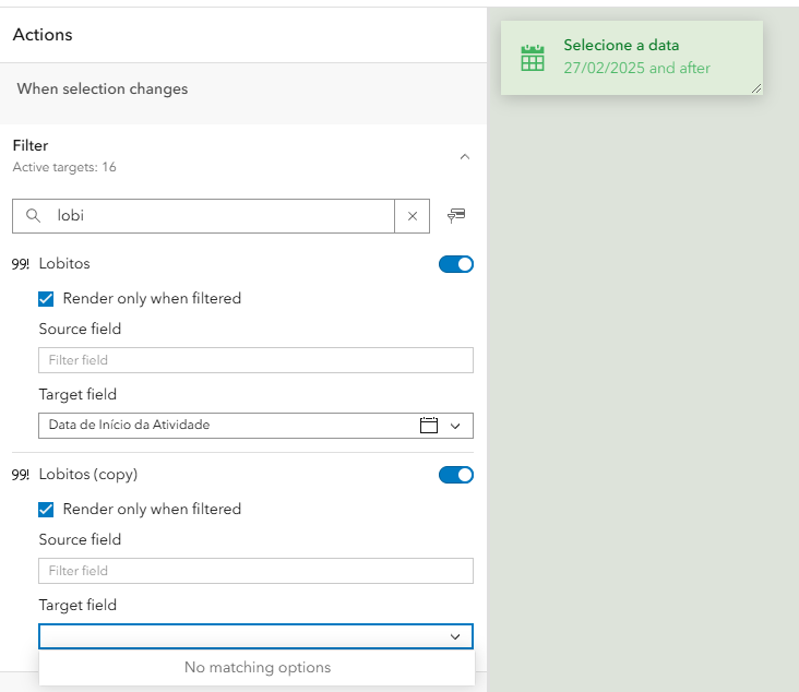

Good afternoon,
I was able to make the sum of two layers that contained a different attribute.
The question here is whether it is possible to bring the date field so that you can make the Date Selector that is in the Dashboard?
Sum of two layer (Via Arcade)

Does not bring the date field in the sum...
Any solution?
