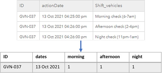

Hello,
I'm trying to pass field values to different columns, and also remove the time in the date (like in the image below). I wrote a piece of code but it doesn't work.

Hi @VeronicaArambula
I believe it is due to the date formatting - expecting in UNIX timestamp.
Also helped to modify the date (remove time) and logic for counting if false (changed to null)

VeronicaArambula
Oh wow!!! Thank you very very much!! It works 🙂
I'd like to ask you one thing:
1. why is it necessary to add the start date and then use the DateDiff?
SzuNyiapTang
Hi Veronica,
For the date field, it is expecting in the format of Unix Timestamp which is the elapsed time after January 1st, 1970 at UTC.
Cheers,
Tang
