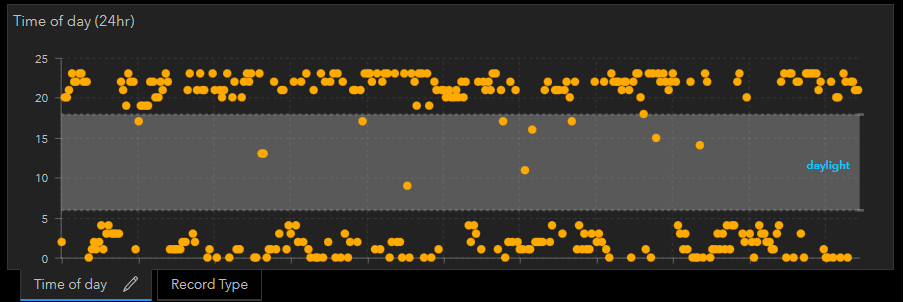

Seeking some assistance with what i think is just a formatting problem.
I've used this script in a data expression to power a serial chart showing the time of day in 24hr format for a dataset collected in ArcGIS Collector. The original reason for doing this as a data expression was to gain access to a field that just had the time of day (or rounded up to an hour value from 1 - 24)
Everything works well at this stage
What I'm trying to do now is include the original creation_date field in the featureset so that I can filter this field with a date category selector. As it is now, the creation date field is being treated as a string and when I attempt to apply a filter a this data expression via the date category selector, there are no valid fields to choose from.
If I change line 18 of the code from esriFieldTypeString to esriFieldTypeDate, the featureset doesn't return any records.
The creation_date field is actually of type esriFieldTypeDate, so the problem must be with my scripting. Any suggestions are most welcome
