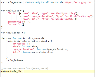

With the Arcade language, I try to feed a dictionary with several fields of which one field is of type date.
This dictionary is fed from a feature service.

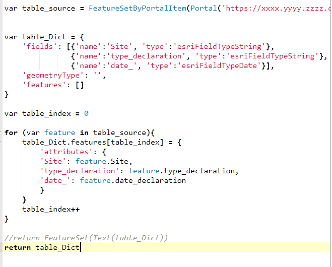

Here is an example of my code:

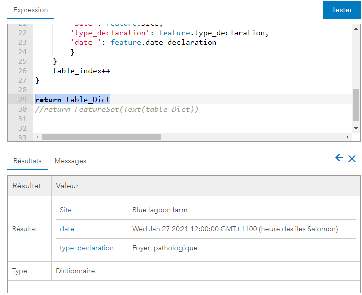

If I return the contents of my dictionary, I can see the date value.

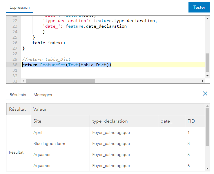

But if I try to flip it this way:
return FeatureSet(Text(table_Dict))
Date values not appearing !
Can someone help me with this?

With this week's update to Arcade and ArcGIS Dashboards, date fields in feature set constructors now just work. You no longer have to pass dates in as EPOCH if you pass the dictionary into the FeatureSet() function (which as of this release accepts a dictionary as opposed to only text based JSON).
Instead of:
return FeatureSet(Text(dict))
Do this:
return FeatureSet(dict)
Learn more in this blog post
