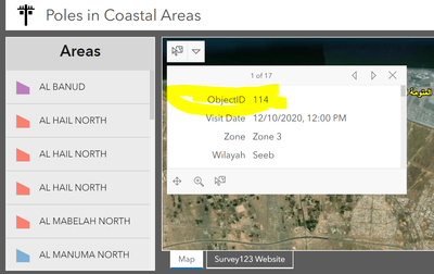

I have a survey presented in the dashboard and the object id is there!
Hussam_AlJabri_0-1639173612778.pngHussam_AlJabri_0-1639173612778.pngHussam_AlJabri_1-1639173683524.pngHussam_AlJabri_1-1639173683524.png
