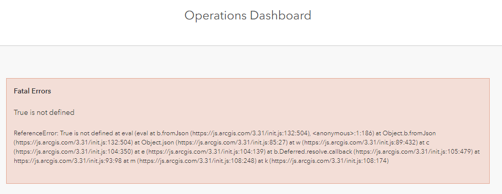

We use a dashboards with a lot of gadgets, which are very time consuming to make. We started using a JSON template and manipulating the code, and paste into a the Dashboard code on ArcGIS Online Assistant. Which is still time consuming.
Recently I learned that I can edit the data of a item by using the code
 gis.content.get(item.id).update(item_properties="text": data)
Which data us the .JSON file. It works perfectly for Web Maps, when I use the code to replace the JSON. But it always give me an error if I try to replace the Dashboard .JSON of an existing dashboard.
In the same way, I can create web maps using the
gis.content.add(item_properties="text": data)
but when I create a dashboard, the error above appears.
An easy answer would be "My .JSON is invalid/broken/has errors", but if I use the code above to replace to the exact same json code of the current dashboard, it still changes to a functional dashboard to a broken one.
Maybe these codes are not suposed to be used on Dashboards. Then, how can I update the Dashboard Json using Python? Is there another way?

You need to use item.update(data= NewJson) instead of add.(item_properties="text":data)
I do it in one of our dashboards as we need to dynamically update the date selectors when the data set is updated.
